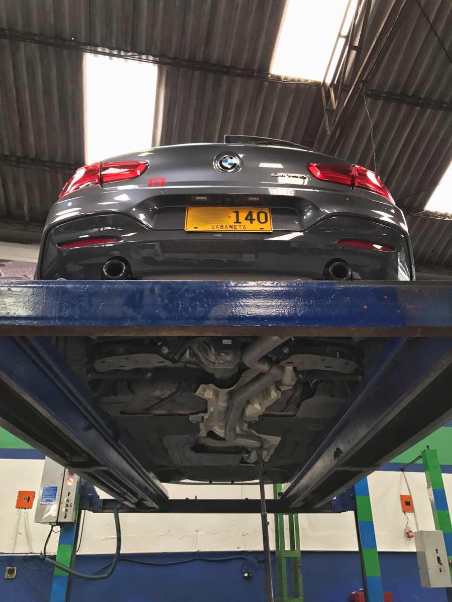

Hey guys, I'd like to present my F20, it is a Mineralgrau Metallic 2017 M140i 5dr, RWD, Steptronic.
I've already retrofitted/added a few bits: NBT Evo iDrive 4, M2 Extended dashboard, GAZP front splitter and Dinan Midpipe.
Hope you like it, greetings from Colombia
BMW M140i RWD AT - 2017 - Mineralgrau Metallische - DINAN Midpipe - M2 Extended Dashboard
