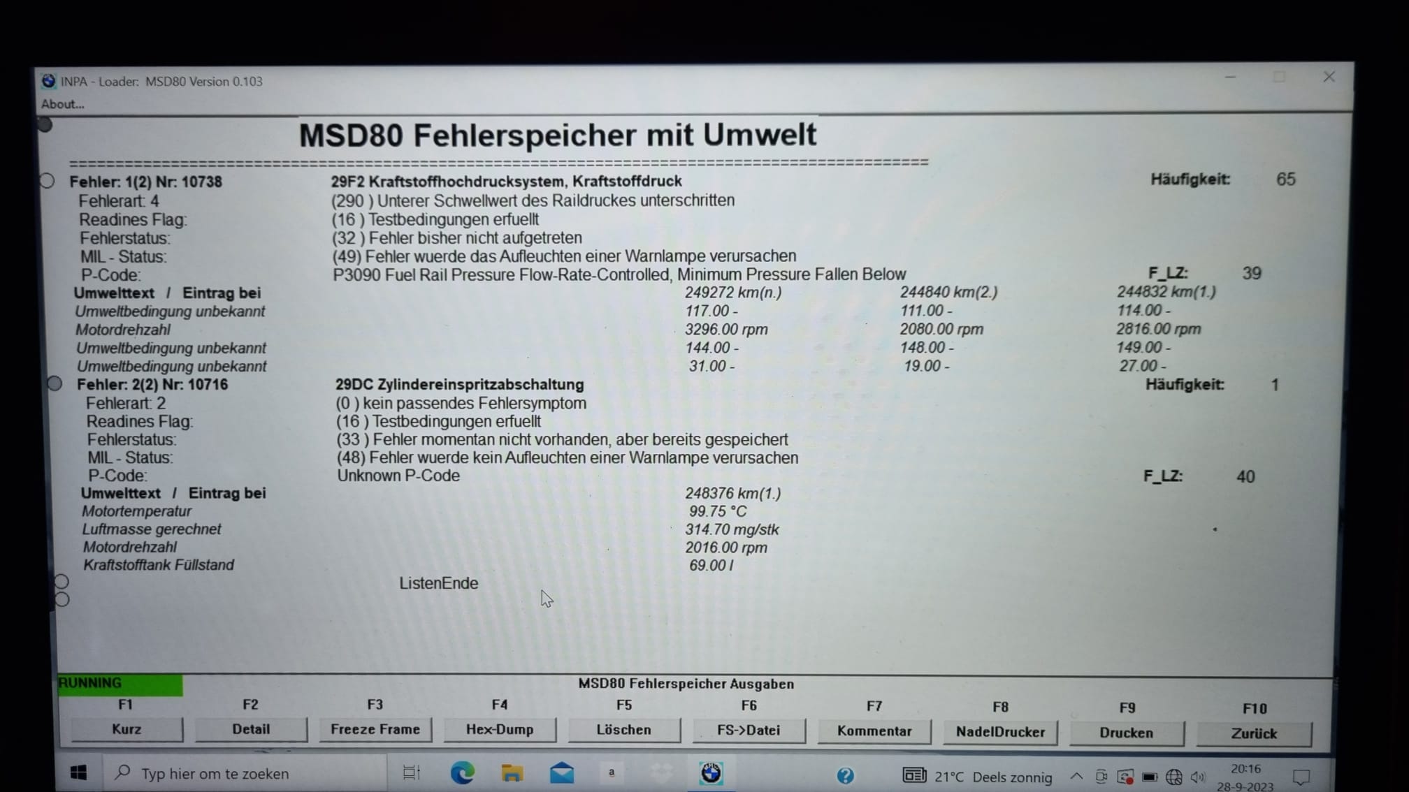

Hello, when i accelerate my car (E60 525i LCI N53) the car gives a shock and goes into safe mode and half engine light goes on sometimes.
So i got INPA and read the error codes, and it give error code 29F2 HPFP minimum pressure fallen below.
Name:  WhatsApp Image 2023-09-28 at 22.13.08.jpeg
When i want to check the fuel pressure in INPA, this is just empty and not showing, how can i get INPA to show me the fuel pressure?
it has to be on the right side on row 5 and 6.

Hi, i did not mannage to show the fuel pressure.
But i got all the injectors out and cleaned the tips, and replaced the high pressure fuel pump did resolve te problem.
I also changed the fuel filter but i dont think that was the problem.
If u pull out the injectors make sure u put them in back at the exact same location.
