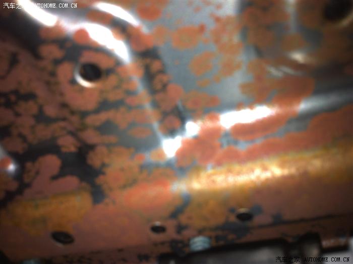

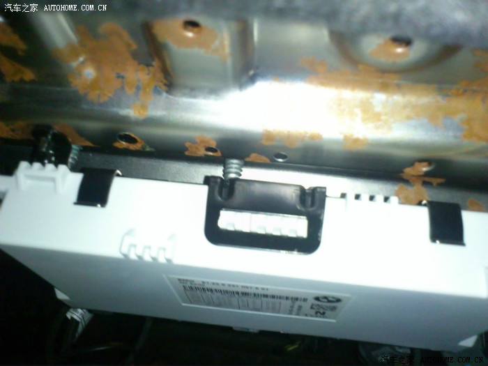

There are reports of wide spread of rust under the front seat frame on F20 in China and Hong Kong.
A number of F20s are affected, including 2011 made and 2012 made F20.
The parts affected is part 1 in the diagram:
http://www.realoem.com/bmw/showparts...57&hg=52&fg=10

F20 owners around the world, please check under your seatframe!
It's a very serious issue here in hong kong and china. Most of the 2012 production cars have this problem. Rust will weaken the seat frame structure prematurely, essentially becomes hazardous when stress is applied to it. ( for example in an accident). Hopefully BMW will have a recall bulletin on this for a replacement soon.

Hi.... Here in the Uk i have just checked mine, a 2012 F20 SE with Sports seats... Rust is there alright... Not as bad as the example shown here but on the way... Strangely though, the passenger seat is fine...
I have already approached my dealer and the car is booked in later this Month so as they can take a better look...

I also have rust on my July 12 M Sport..
Will be speaking to my dealer shortly!!

Wanna see mine?

I'm from the UK and have rust on both the driver and passenger seat bases. My car is March 2012 Build 118i M Sport.
I'll let you know what my dealer says when I have a chat with them in the morning.

Called the dealer in Hong Kong. He heard abt it but there is no recall notice from the company. He said will let me know as soon as he hear anything. He said I could address this issue during my 1st service...

With the high temp & very high humidity in Hong Kong, it'll just accelerates the spread of rust. I have to put dehumidifying packs on every seat of my 635, just to keep the mold from forming. I think conditions like what we have here in HK can't be replicated in Germany, thus underestimating the severity of the problem.

F20 125i, built on march 31th (Regensburg plant). I checked my car and the rust is already here on both driver and passenger front seats !!! This is really a shame for BMW . This rust should appears very easily. My car is day and night in a closed garage. I live in Paris area (mostly dry and not so hot weather).
I don't think that this issue is that important. Do anyone knows if a similar defect has been observed on the F30 model ?
